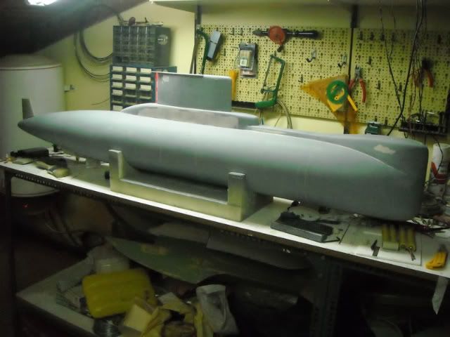

Hallo
New in this forum and this is the project I'm working on for some time now! Scale 1/32 and the length is 175cm

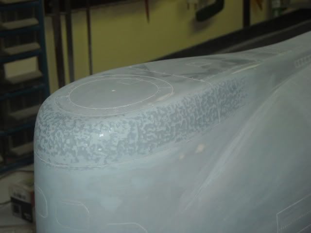

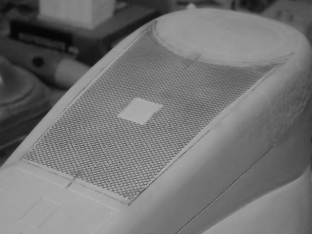

Hello,
nice work, is the hull shown in your project made by your self? And how did you make the engravings so perfectly.
regards
Chris
Ein U-Boot das nicht taucht taucht nichts!
type 209/1200 Hellenic Navy 12 Jahre 10 Monate her #25583
  • bassplayer1
  • bassplayer1s Avatar Autor
  • Beiträge: 108
  • Dank erhalten: 1
Hallo Chris and thank you for the nice coment!
Yes, the hull is made by myself using blue foam. Then it was covered with 220gr gass cloth and epoxy. That's going to be the prototype for making the molds. As for the engraving I use nothing exotic but a strate edge and self made stencils where necasery out card or fibre glass sheet! I enclose a photo of the tools I'm using.

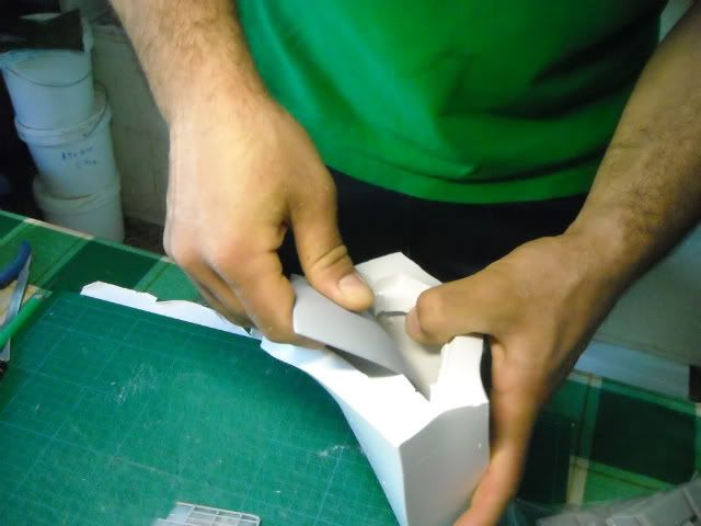

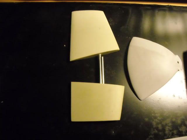

type 209/1200 Hellenic Navy 12 Jahre 10 Monate her #25628
  • bassplayer1
  • Beiträge: 108
  • Dank erhalten: 1
Good morning
Here are some photos of the casting and detailing the dive planes and rudders
